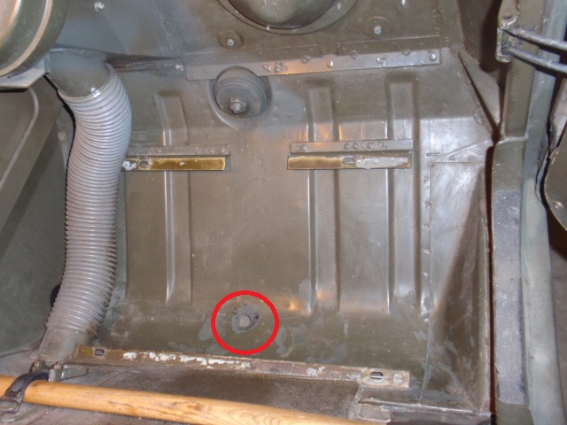

the drain holes in the floor do not directly align with the drain holes in the rib. the hole in the rib is further aft by an inch or two. if you drill drain holes don't forget to prime and paint afterwards. these photos may help in the outer photo its a bit hard to see the hole however it should help give you an idea of its location.
- floorhole2.jpg (123.32 KiB) Viewed 6462 times
- floor hole1.jpg (113.13 KiB) Viewed 6462 times
- drainhole1.jpg (142.79 KiB) Viewed 6462 times
Re: rubber drain valves in front footwells of Pinzgauer
Mine are in the centre rib, directly in line with each other on the inside and outside (top and bottom) and at the very bottom of the footwell. Not to the back as in your pictures, unless I am viewing your pics incorrectly.

And I can push a screwdriver straight through both holes, with the screwdriver essentially perpendicular (square) to that section of the floor or rib. Assuming this is a factory hole, it might be that they did not have any specific criteria for aligning them during construction.
The hole in my reinforcement channels under the floor are NOT at the low point which allowed sand and moisture to collect and block the hole. I'll be replacing the driver's side channel this spring.
