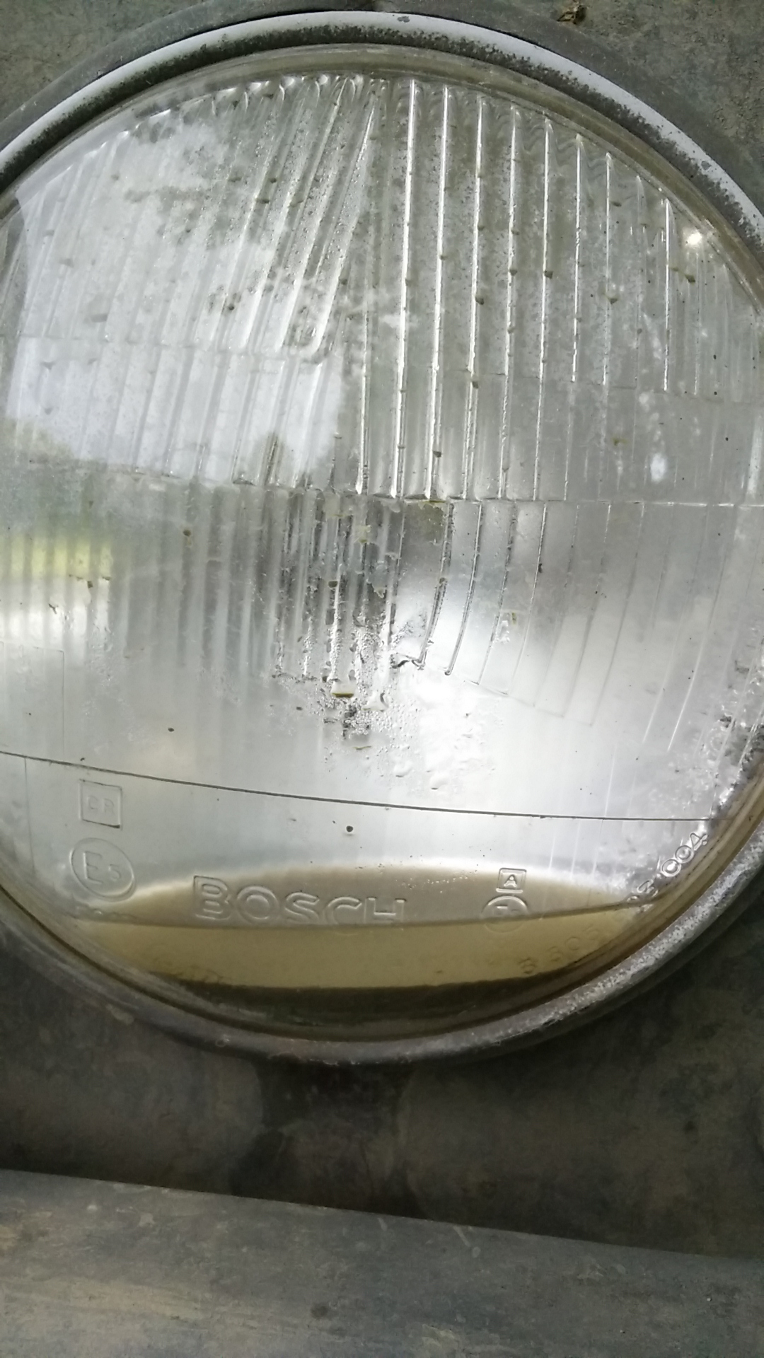

To Commander of Pinz Sub,
It looks like you've been under the sea for a while, as evidenced by the water in your fish bowl, er... headlight.
(New gaskets in the lights might prevent this.) Based on the fish bowl, I'd be suspecting watery electronics too.

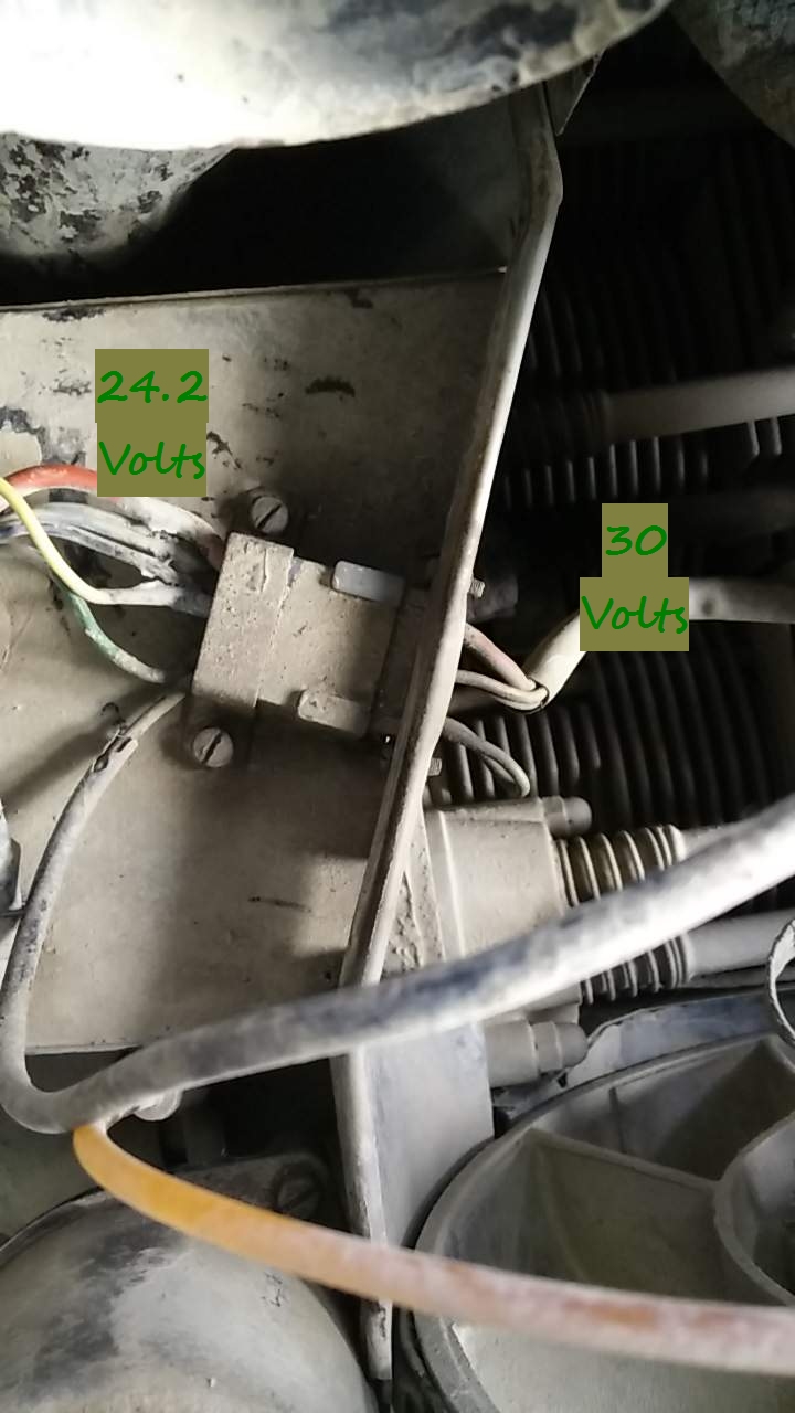

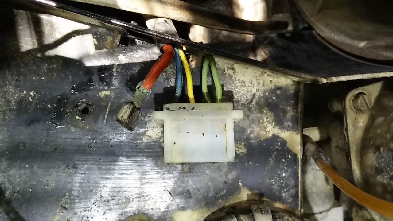

On the alternator, The "B" Terminal read 35.5 volts. At the other end of the wire, Probing the back of the molex connector on engine side, I read 30 volts. Probing the outside of tin, red wire only reads 24.2 volts. So I have a connection problem. Ok. But why the voltage drop from alternator to inside molex terminal? Is that a resistor wire? And back of Alt is reading 34 volts.

- molex
- IMG_20150529_Molex with text.jpg (205.87 KiB) Viewed 7287 times

Your last photo is very telling - any good connection will have essentially identical voltages on both ends; a very poor connection or no connection is the only reason for different voltages (24 and 30V).
If I assume you measured the 30+ volts at the alternator bolt then there the most likely culprit is still the Molex, but we did have a member a few years ago who found that the wire itself (from the alternator to the inside of the Molex) was open. Some auto wiring includes "fusible links" which is a wire that is intended to become open, like a fuse, inside the insulation as a safety feature. I do not have any idea if Steyr used any fusible links but in that instance they were getting ~70V at the alternator bolt and ~24V on the outside of the Molex. The point is when you see differing voltages at ends of what is supposed to be a current carrying path (wire, connector, mating connector, etc.) there is something wrong -- and don't just "assume" that the wire is good, it might not be good.
