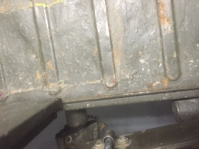

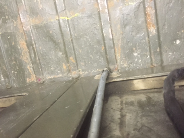

Hi all - have a 712M with a split tailgate/ barndoor tailgate. Part of the latching mechanism is a vertical pole that slides up and down when closing the door. I feel like there should be a receiver for the pole in the bed of the truck, but see no evidence, and i can't find any mention on this forum or my owners manual.
Anyone have these gates? pictures to follow... appreciate the help
- IMG_1788.JPG (99.13 KiB) Viewed 5438 times
- IMG_1787.JPG (97.81 KiB) Viewed 5438 times

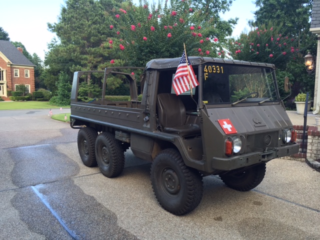

- set up for a fourth of july parade....
- IMG_1734.JPG (152.36 KiB) Viewed 5424 times

Your truck may have been a conventional 712M ( with a single door)and the doors retrofitted from a Rapier truck and the the bottom strike hole not drilled. The Rapier doors would have been noisier and rattled more.
Look for holes drilled on the inside of your bed area for telltale signs of missile racks.

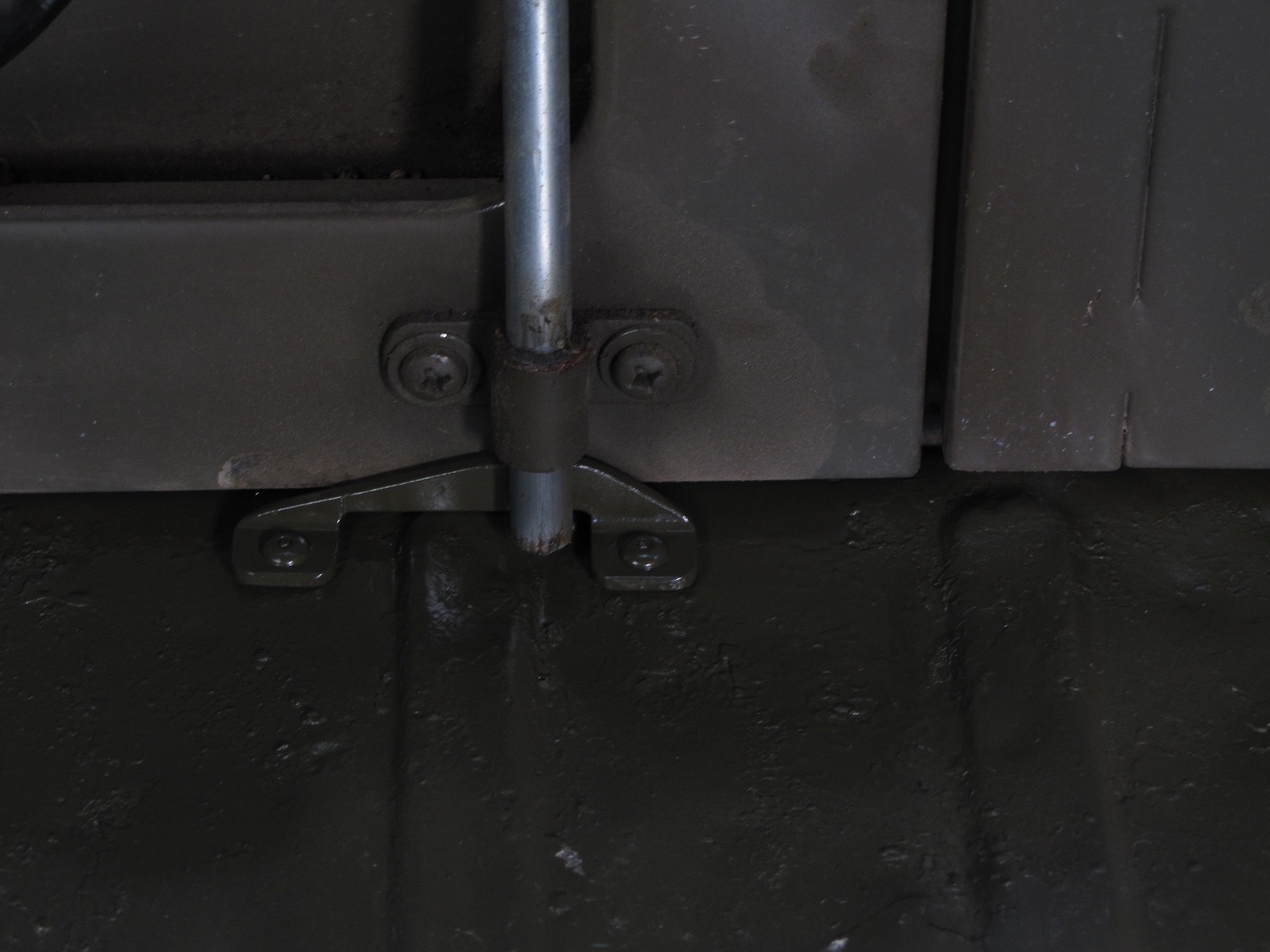

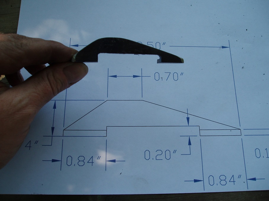

Those are the Rapier doors; I have the same. They actually latch into a lip on the missile storage racks that were originally installed in the rear of the truck. You will have to make a simple latch and attach it to the bed of the truck to have the doors secure properly. I made one in about 15 minutes from a piece of 1" A36 steel angle. I'll try to attach a photo and maybe an image of my original CAD drawing for mine.
If I recall, I secured mine with strong steel Marson brand rivets I got from Fastenall.

Actually, the Rapier doors were never installed by SDP, they were retrofitted later by another Swiss company; all Rapier trucks started life as a 712 M. There actually never was a strike hole, or any other holes drilled in the truck to mount the missile racks. All the racks were mounted using the existing seat mounting holes. My truck came straight from Switzerland and I was the first civilian owner, so it still had the racks installed when I got it. Mine is also a 1976. I think the doors themselves were actually made by a company called Hesso, if I recall correctly.
Too bad you didn't get the missile racks, you got cheated out of a nice six pack jerry-can rack that also came installed in the rear.

With a latch striker installed, there should be no rattling whatsoever; my doors latch up snug and tight with no issues whatsoever. I actually prefer them and they are great for loading and unloading camping gear from the bed, the only issue is that you need to find an accessible place to keep your spare tire. I keep mine in the rear, in the well, near the doors, but I built a deck that bridges the well so I can store camping gear on top, while still able to easily pull out my spare in case of a flat.

Nice, thanks for all the great feedback and ideas. That's a great looking strike plate you made there centar712.
No missile racks for me unfortunately... I guess I'll make a strike.
You're right, I do recall seeing 'hesso' on the doors.
The latch on the door looks to be of a slightly different build / vintage than the one on SAV diagram, like the rest of the truck it's over engineered to excess.
