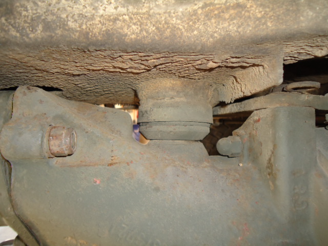

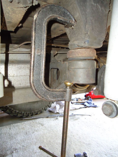

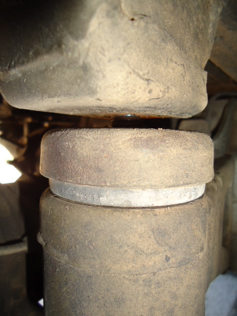

Re: Hand Brake issue.
If this is the one you are talking about, I think Paul is giving you the best possible answer. I can't see any other way to get to it.
After doing my repair I had real trouble getting the body back down to install the outboard bolts and had to use a 'C' clamp to get it together.
