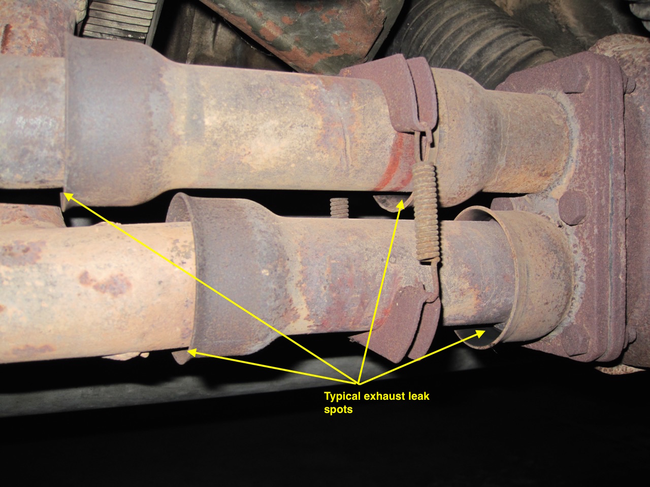

Here's a photo of the original exhaust slip joint between the header pipes and the heat exchanger. This is a common spot for exhaust leaks.

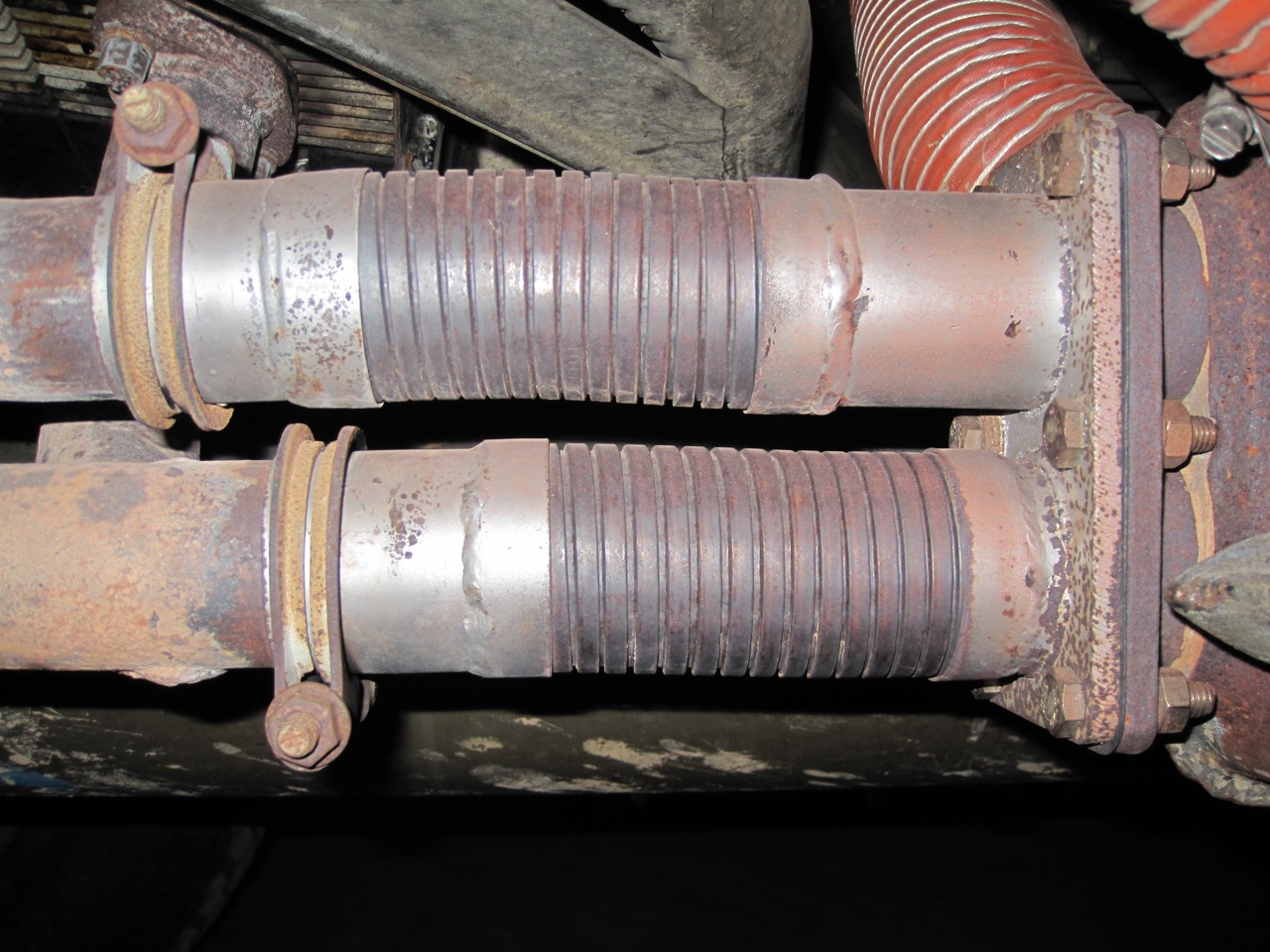

Many owners have replaced the slip joint with the flex kit from EI or SAV, like this:
A good exhaust shop could also probably weld in some SS flex pipe for you if that's where the leak is occurring.
