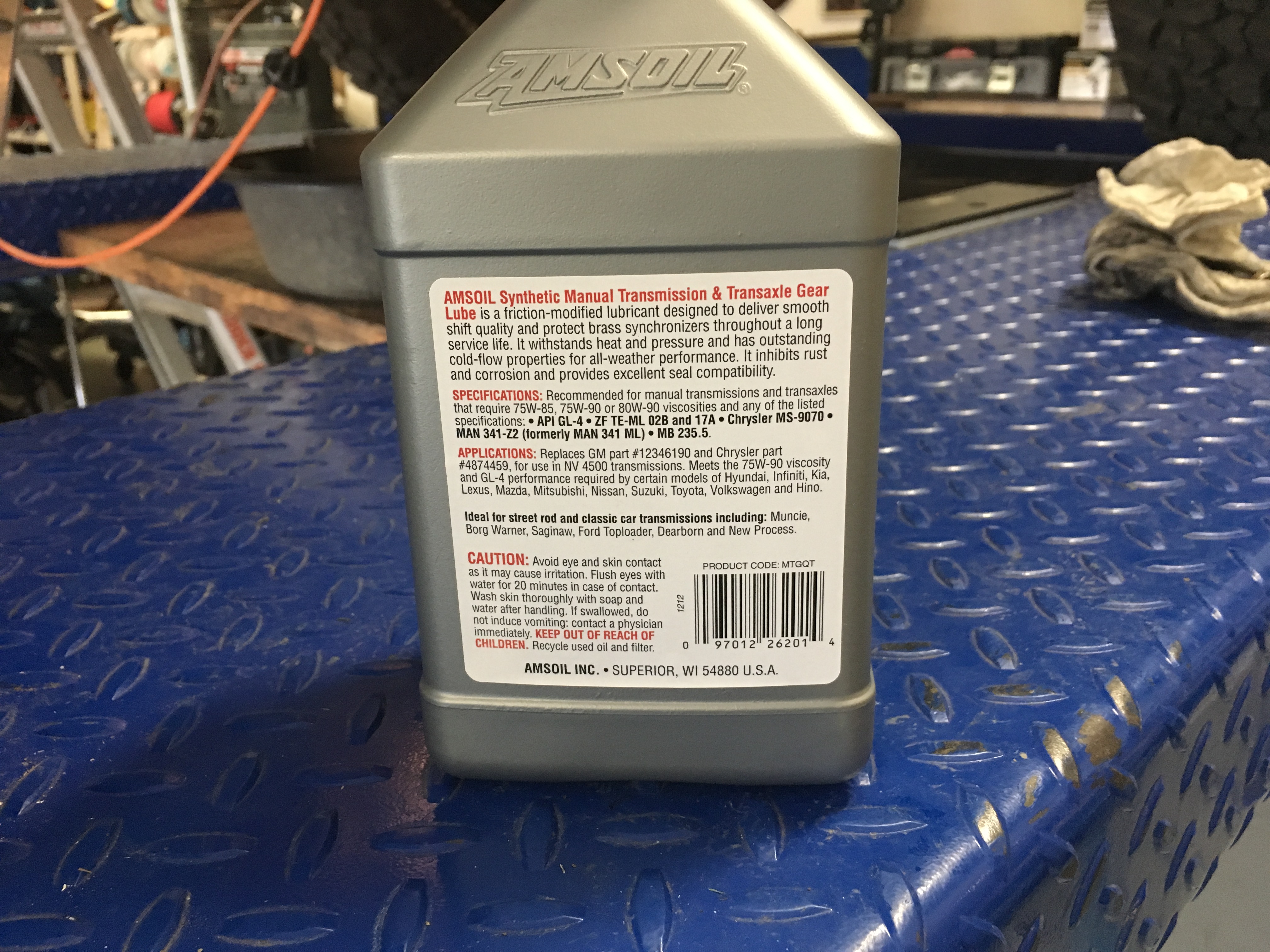

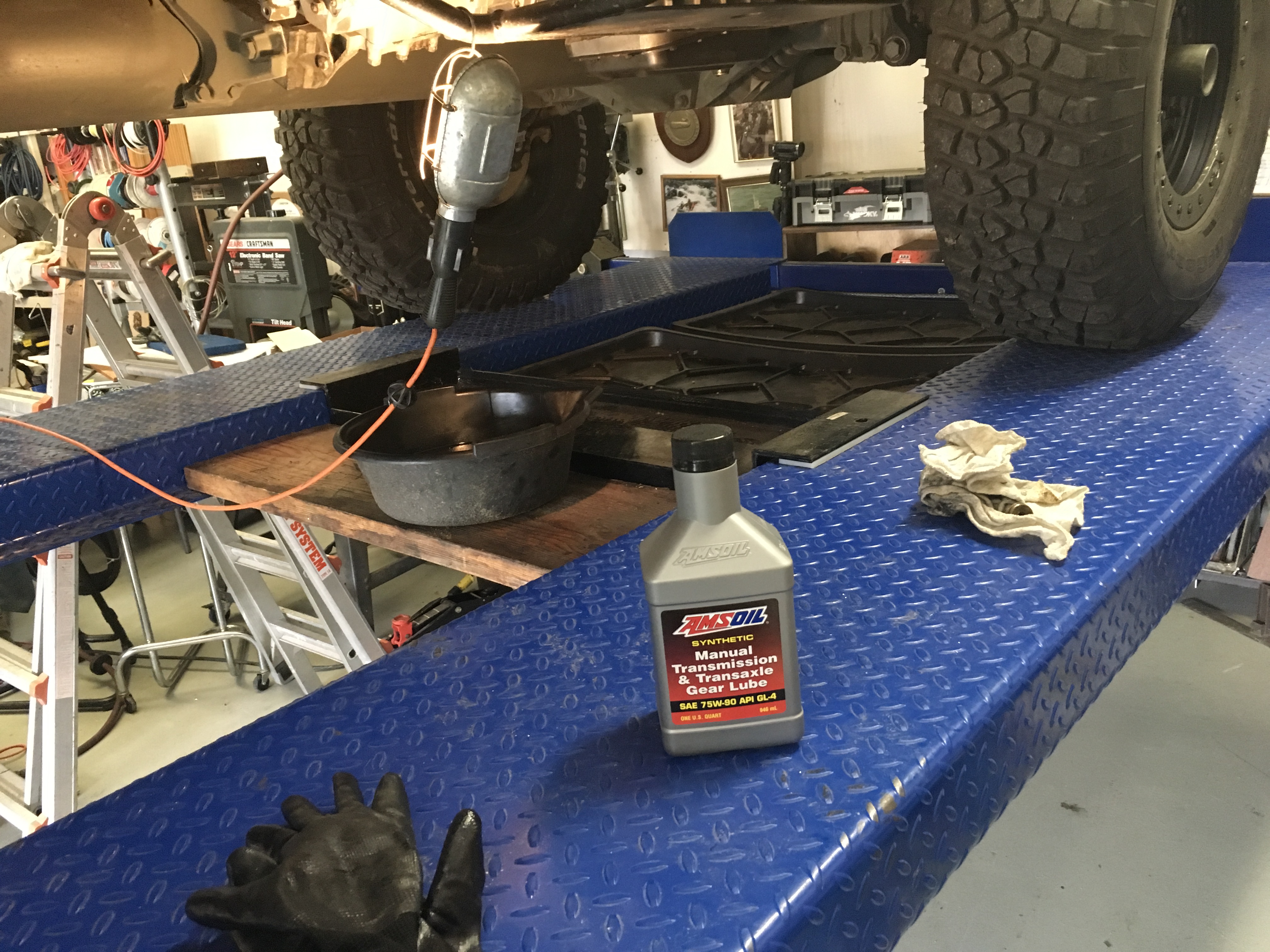

I am going to give some of this a try. I will post how it does in the future.

That looks like it says all of the correct things on it for use in the tranny and tcase. I'd still go with Redline myself...
Using a lift would make it much easier...
