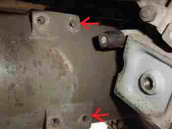

In my quest to to get this 710m ready to go for the nice weather, I am going over things I read about here and on SDP. One of the "easy" projects I planned on tackling was the noise reduction technique. After removing the tranny cover plate from inside the bed to get a better look at the tranny mount, I noticed right away that the inner top bolt was loose. Unfortunately, the problem is that the welded-nut has spun loose :evil: ! I then got under the truck and found that the lower, inner bolt was missing! On closer inspection, it had been snapped off and left inside the welded nut :twisted: ! What idiot does that???
Anyway, I went ahead with the rubber hose add-on, but now I am stuck as to what I should do about the broken weld-nut? Can I slip a nut in there and hope I can get a pair of pliers in their to hold it when I tighten it?
The bottom bolt I will drill out an hope to salvage the nut.

On the bottom nut , left hand dril bits are the best bet for removal of broken studs. The heat from the drilling will sometime heat the stud up, the bit can grab the stud and they'll just unscrew... start small and work up on the bit size.
On the top nut, if the nut has broken loose, and you can get it out without damaging anything else, weld a nut to a flat strap of steel and slide it into the bracket from the end and on reassembly' once the bolt grabs it, you won't need to hold it and the steel keeps it from turning

I was able to remove most of the upper spinner with a hack saw (to loose to drill) and then popped it out through the side. The lower bolt had to be drilled, but still wouldn't budge with the extractor, so I smacked it back through the bracket. I picked up some 10.9 replacement bolts and nuts and Krick's method worked well. I actually only had to use my finger, and once the bolt bit, I was able to torgue it right down without it spinning. Now to get back to the rub rail and the fluid changes! :D
