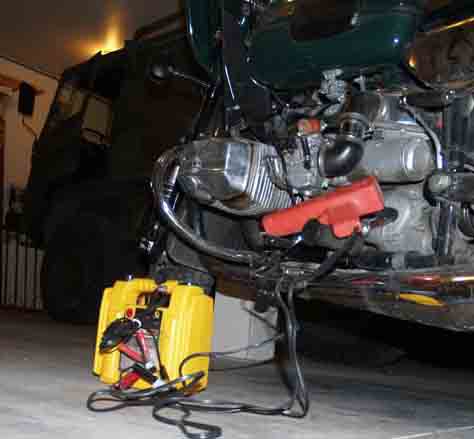

You should be able to power your timing light from either one of the trucks batteries.
However the way I do it is to use a small jumper battery as in this photo. You could use any 12 volt power source with adequate capacity to power the timing light. It really doesn’t need much.
By using an auxiliary power source I don’t have to drape power cables across the running engine.
Works the same way on the Pinz as on the bike the only connection required to the vehicle is the inductive pickup attached to the number one plug lead.

Thanks Ed, I will give that a try!
