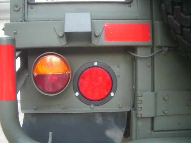

Re: SAV Swiss Style LED Taillights
Kept the original and added LED from Grote. Very bright and take the place of the reflector.
