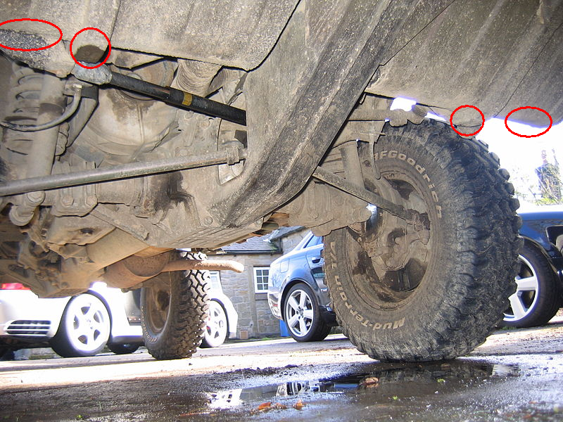

The front bottom of the tub where it is reinforced for the bumpers looks pretty strong but would be strong enough to jack up under these points? Maybe with U shaped steel plates formed to fit on the outside of these would be better? I don't have a crane or a forklift and will be working in a small residential garage that the truck barely fits in sideways.. Luckily it is long enough that I can roll the drive train out after lifting the body up..

The areas you indicated are NOT strong enough to lift from. The one's circled are usually fairly rotted from the in side. Check the drain holes just aft of that area. The outer areas are also not that strong. I know someone will chime in with a solution soon though.

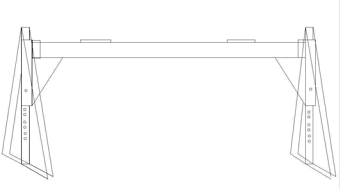

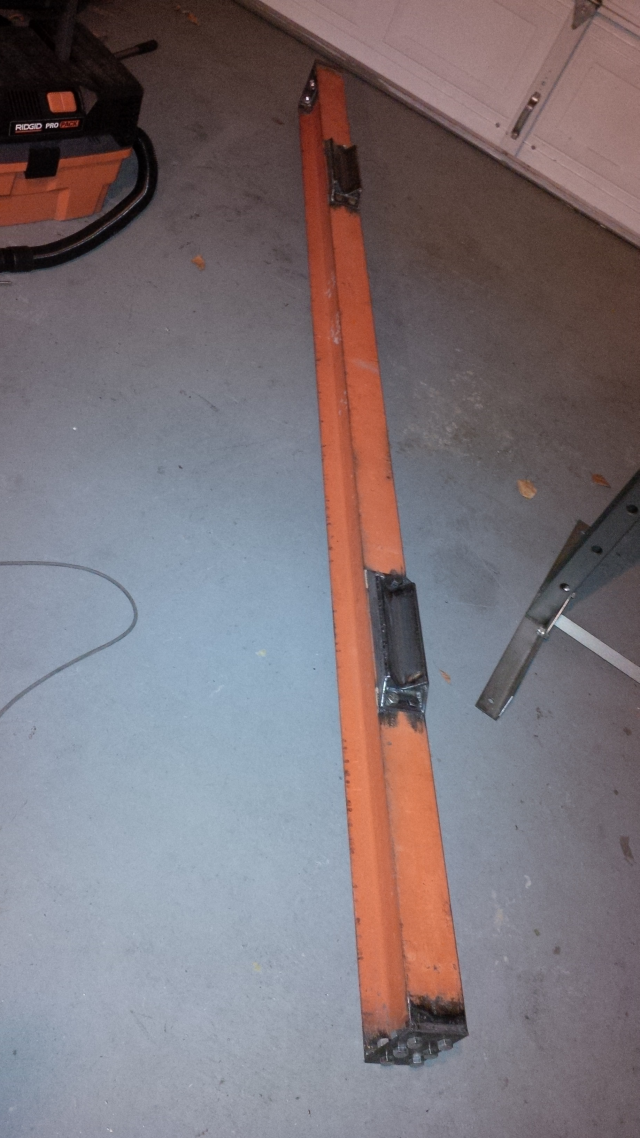

For the rear I am planning on using a 6" x 9' I beam that I bought on craigslist. I made some V blocks that I bolted to the top to keep the bumpers from slipping off.. Originally I was just going to bolt on a couple of pieces of channel steel on the ends to keep it from tipping and stack cribbing lumber under it.
But now I want more height and was thinking of making something like this with 3" square tubing:
I guess the front one would have to look more like an air lift bumper jack of some sort..
But taking the wheels off first and then lowering the drivetrain onto platforms with caster wheels is a good idea.. I will have to think about this some more...

If you've got the height and an I-Beam to span the width, why not just put some tube up under the beam to support the vertical weight, brace it all to the walls, then lift the complete body with that......I lift the bodies with a single lift point attached to a basic cradle (3 metre X 100mm square X 3mm tube)
