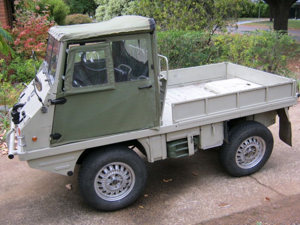

It depends on the alloy wheel - the Fiat ones I have on mine take the standard Haffie wheel nuts but other wheels as you say may need different wheel nuts.TechMOGogy wrote:Just remember that if you go with alloys you will need to get new nuts - lug-centric.
You can get suitable nuts from http://www.brandsport.com/gorilla-lug-n ... AuvD8P8HAQ
My Haffie with the Fiat 14" rims

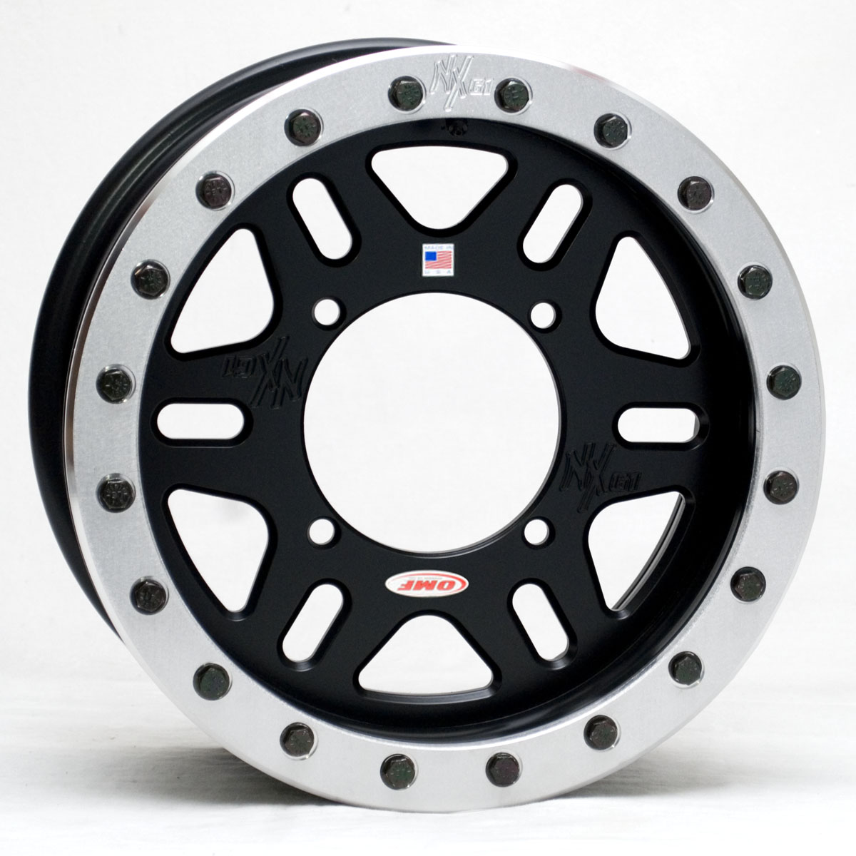

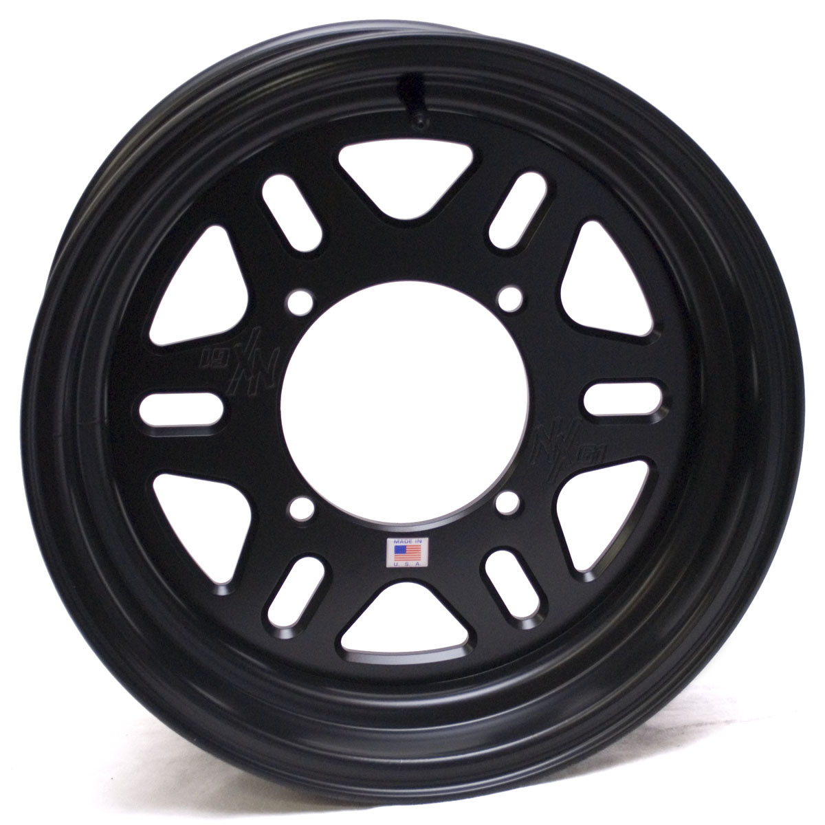

The custom wheels I was looking at are nice but I don't think I want to spend that much. $250 each for the steel and $400 each for the beadlocks. Back to Fiat I guess?
