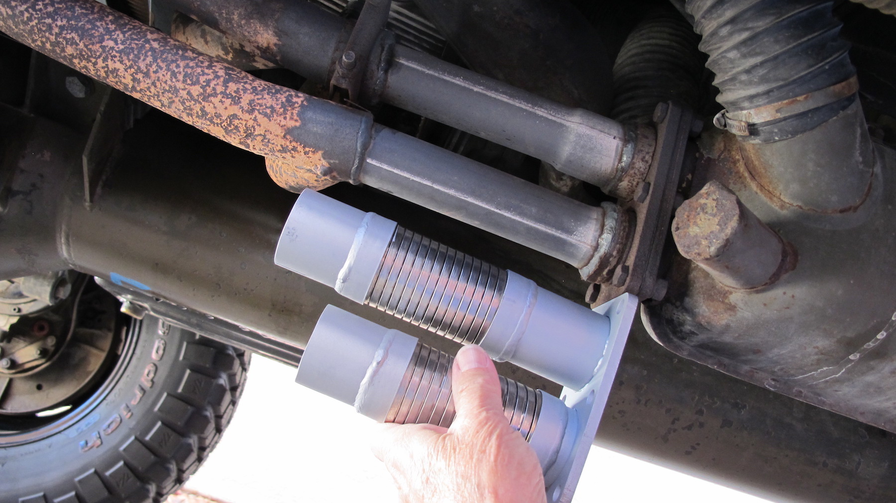

Got the SAV Flex Kit today. Existing exhaust headers are short and messed up, so I ordered new "used" headers today. The Pinz is a money pit already!
IMG_1311 copy.jpg (443.03 KiB) Viewed 7391 times

We finally got to putting in our SAV flex kit this week. We also bought used exhaust manifolds from SAV since our's had been hacked up. My brother did the work with me as the helper. It took one evening grinding the rings off of the new used headers, one evening removing the old headers, and one evening to install the new flex kit and exhaust manifolds.
We were lucky. No broken studs. Two studs came out with the nut. It was terrible getting the flex kit to heat exchanger bolts, lockwashers and nuts on because of interferences. And it was very hard to reach one exhaust manifold stud to get a nut on it and tighten it. But overall we were pleased with not having serious issues and in the time it took.
We left the heat exchanger and muffler installed. We bolted the flex kit and gasket up to the heat exchanger first with shorter bolts (25 mm) we purchased since the SAV kit bolts are too long (30 mm). Then we slid the #2,3 exhaust manifold into the flex kit and attached it to the cylinder head. Then we slid the #1,4 exhaust manifold into the flex kit and attached it to the cylinder head. We used anti-sieze on the stainless steel flex kit flange to exchanger flange bolts. We used Loctite blue on the exhaust manifold studs to the cylinder head, and to the nuts. We torqued the exhaust manifold stud nuts to 24 Nm.
We also put a new SAV muffler on. We haven't driven it since we installed the flex kit.
IMG_1880 copy.jpg (482.46 KiB) Viewed 6963 times
