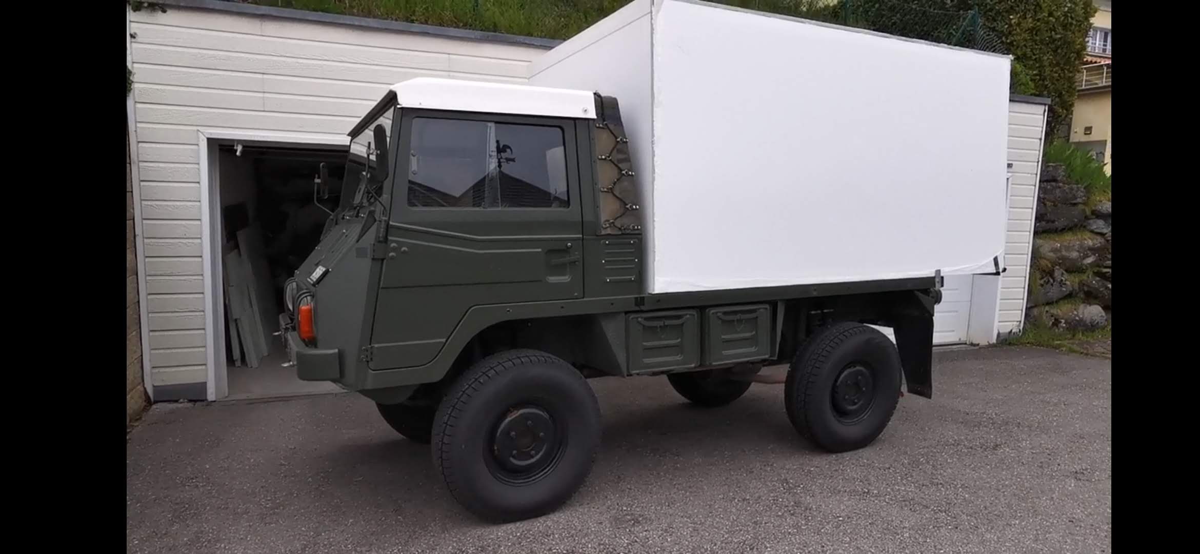

Box mounted on Pinz 8) 8) 8)
Same weight as the tarp and structure I removed, so net weight gain = 0 :D
