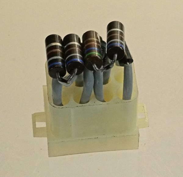

All of my dash indicator lights are not working. Saw Andre last week and he was saying that it is probably the Diode box behind the dash. Looked at the Pinz Maintenance and Repair PDF files, but no mention of where this diode box is located. Any ideas or photos of where this is located before I start tearing the dash apart?

It is not actually a "box" but is a Molex type connector with a group of diodes soldered to it.
Part # 7112850690, available from SAV.
It is located under the dash behind the instrument panel and is likely cable-tied to other parts of the dash harness. You typicaly don't need to remove the dash panel.
