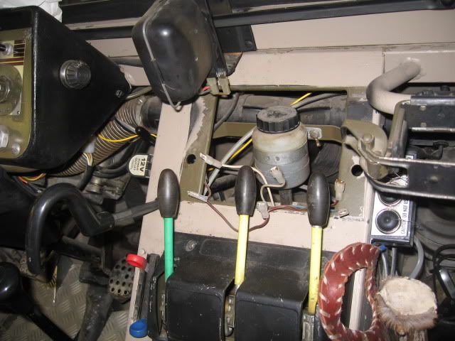

The master cylinder is behind the locker levers in the dash. Bleeding it is (in theory) the same as bleeding brakes. Suck the master dry with a syringe, or similar, and flush the system with new fluids. This is also in the manuals.

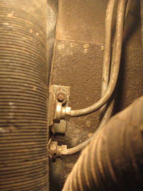

Jerbearyukon
- Posts: 446
- Joined: Fri Dec 21, 2007 4:04 pm
- Location: Whitehorse Yukon Canada
Jerbearyukon
- Posts: 446
Jerbearyukon
- Posts: 446

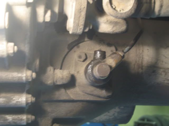

Jerry,

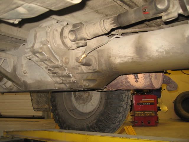

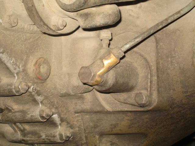

The locker slave is what you've got pictured in pic #2. The two bolts remove the slave, the bleeder valve bleeds it. There are 3 of these slaves on the truck. One is directly behind the front axle (I think this is what you've pictured), one is directly behind the rear axle, and the center one which is directly ahead of the transfer case. From your description, your axle differential locks (levers # 2 & 3) are working fine, but the lock which engages the front axle (lever #1) is the problem (correct?). If this is correct, then only the center slave will effect your condition.
Miles,
You're confusing me, but some people think that's a pretty easily accomplished task...
My reason for suggesting removing the slave was to determine whether there was a problem within the "witches hat" area. Removing the slave should allow the locker mechanism to unlock. Not unlocking at that point (assuming stress on the drive train is relieved) would seem to point to a problem within the locker mechanism within the central tube.
The indicator light being "on" indicates that the slave has moved in a manner such that the locker has engaged. The light staying on after the lever is raised means that the slave has not yet retracted (for whatever reason). I don't think it's really indicative of where the problem is, just that there is a problem.
A lever getting solid is an indication that the fluid did not return from the slave up into the master when you raised that lever. The master cylinder piston then took another "gulp" of fluid. Then, when you try to depress the lever again, it cannot, because the slave has already moved as far as it can, thus the master cannot force more fluid down the lines.
So Jerry, which slave/s did you bleed? Is the truck operating normally yet? I'm still betting you had crap in the lines, just because it's a common situation. You should be able to bleed clean fluid through them when they're bled sufficiently. Was it clear?

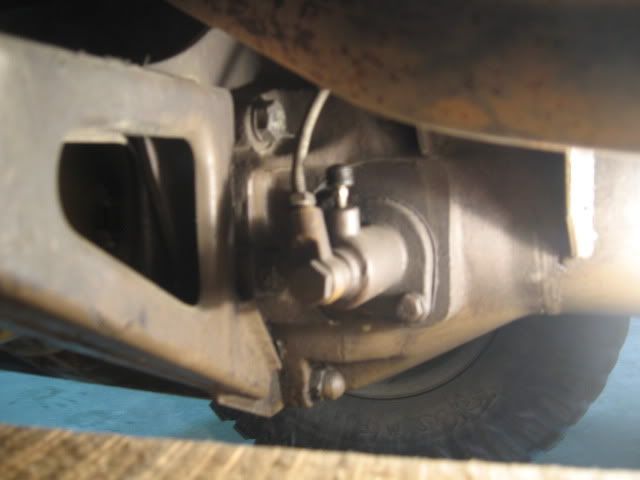

Sorry, I'm stupid. I'm STILL not sure which lever is giving you problems. Is it the left-most lever? (I assume) Or which one?
If it IS the left-most lever, then you need to be working on the slave which is on the passenger side, just ahead of the transfer case. Opening axle differential plugs will not do anything to help. (I'm not too sure why the differential locks would unlock when you opened the filler plug, but...)

NO you are not stupid.....it is the left lever for the four wheel drive mode.
The other lockers go in and out with out any trouble. Maybe it was just coincidence that they unlocked then,,,but the lever after you unlock it (typically) would not unlock it and the light would stay on. You also couldn't put it back in (it was pumped up).
So I will have a look today....so what does the slave look like....does it look like pic number two up above?

The fitting on top of the actuator is the bleeding valve. In the simplest way to explain: Remove the rubber cap on the valve and install a rubber tube ( clear is best) onto it and run the other end into a cup with brake fluid in it ( this is so you don't get air back up into the line).
Now turn the lever down to pump fluid into he line , then crack open the bleeder valve and watch for air or fluid ( hopefully only fluid), shut the valve , THEN return the lever to the up position ( or you'll pump old fluid or air back into the slave). this is best for two people to do. This is all done with single swings of the lever, not pumping. There are "fancier tools" for doing this, but you don't need them. This basically the same way to bleed the brakes orclutch on the Pinz.
Also, when you are driving and return from 4x4 or lockers and they do not disingage, the drivetrain may be wound up... a simple stopping and either backing up or turning for the right to left may relieve the pressure and unlock them while backing.

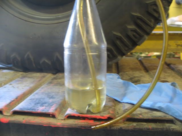

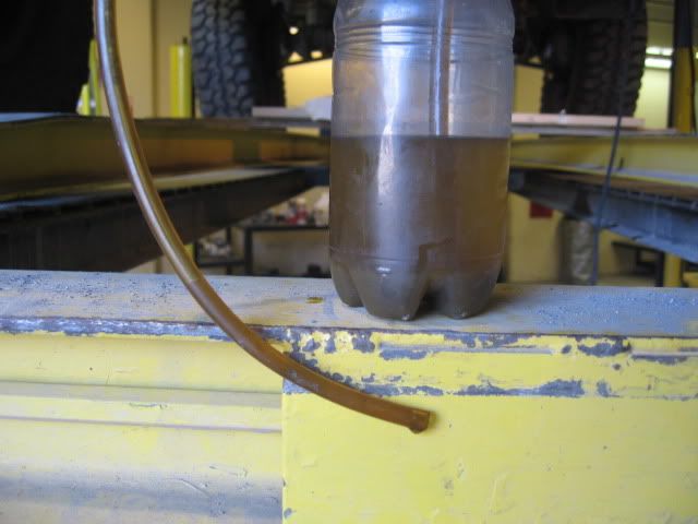

TO FIX IT:
I had to bleed the system.....the bleeder was plugged so I had to remove it first.
Then I got a bottle and fashioned a 1`/4" hose to it and put in som ebrake fluid and put that over the bleeder (boy was the bleeder plugged).
I removed the locker light access panel to get to the main filler bottle for the lockers (sorry about the lack of technical jargin here).
I had to engage the 4x4 adn then lossen the bleeder...then go move the handle up again..jump back under and tighten...then move the handle to engage etc etc....this is what came out of her...bubbles and gunk...could be a new drink for kids right...well looks like ice tea anyway
here is the play by play video...I THINK if more ppl did these it would help ppl like me LOTS.
WILLY IS PLAYING IN THE BACKGROUND...HOW WEIRD IS THAT TO HAVE "ON THE ROAD" AGAIN PLAYING...must be someone looking out for me.
SO I took her for a test drive and all lockers work as they should now...whew...NOW CLUTCH...oh oh.
Jer Bear
