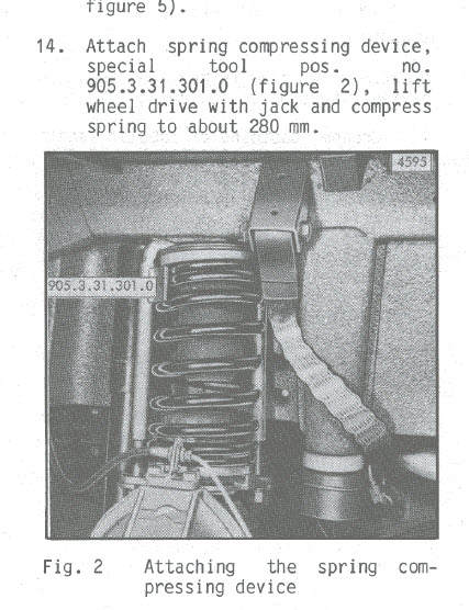

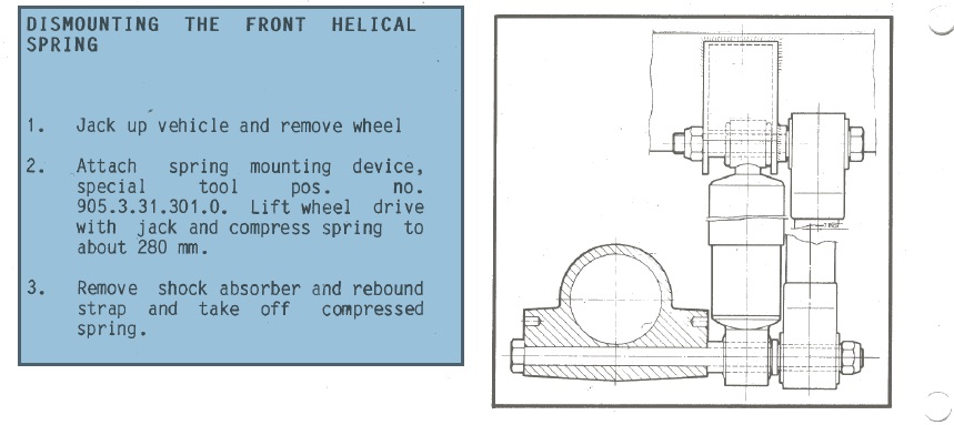

VERY IMPORTANT. Only compress it as far as the manual allows. IIRC, like 10 1/2", but that's from memory. CHECK!! You can damage the spring otherwise.5. compress spring until removable.
Does anyone have a manual in front of them? I have my springs in the car, going to get them banded today. Don't want to mess up the springs......
If not, I'll reference the manual tonight....
Re: Front axle boot replacement quick quesitons.
Page 4 of the BODY Section:stiffler4444 wrote:VERY IMPORTANT. Only compress it as far as the manual allows. IIRC, like 10 1/2", but that's from memory. CHECK!! You can damage the spring otherwise.5. compress spring until removable.
This may help too:
Here you go: 280 mm = 11 in
- Front Spring.jpg (73.71 KiB) Viewed 6121 times
