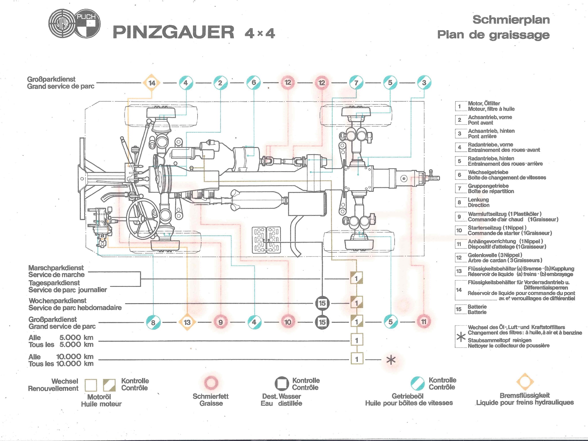

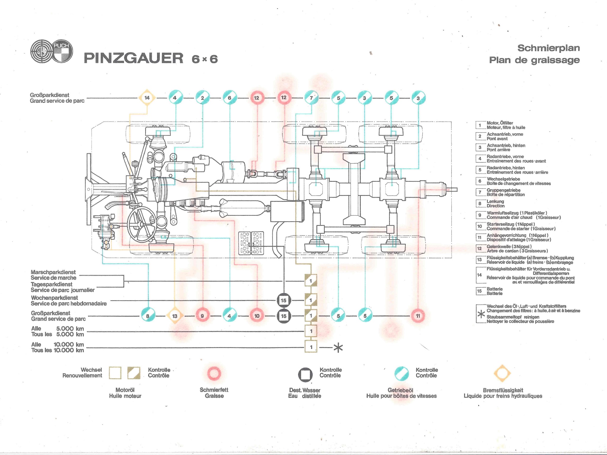

These are the PDFs I scanned in from their original German Service Manual. They were front and back, so don't mind the slight discoloration.
