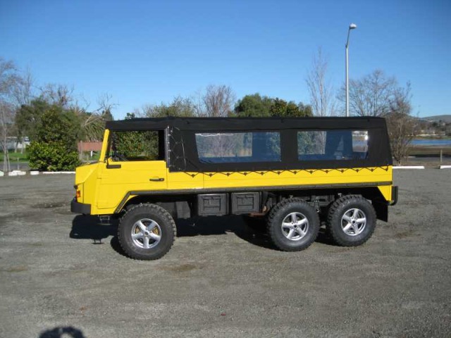

We are using a wheel on our tour conversions that is made in the UK for the Sprinter vans. They are relatively inexpensive, look good and are pretty much a bolt on conversion. You will have to change out the wheel studs to a Conical Lugbolt, we found the correct ones in Italy! Retail price in the U.S. is about $175 a wheel and $2 a lug bolt.

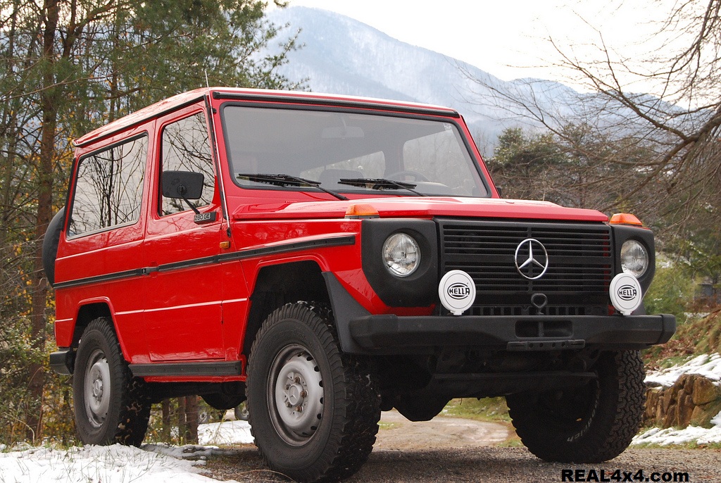

I can't recall for sure but aren't the stock steel/military Gwagen wheels the same as the steel TD wheels? Like the green ones on the back of that pic?

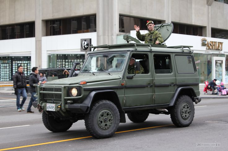

I like the older Euro/rest of the world military, or those newer Canadian mil. version:
- G.jpg (339.6 KiB) Viewed 8929 times
- bf14a51e2d50fef07e8beaec52231a73.jpg (59.99 KiB) Viewed 8929 times
Re: Atik G wheels
The Hutchinson Wheels are my all time favourites (Canadian G) but at 876 euro each (I have seen them available a little cheaper from a few specialist suppliers) I think I'II be waiting for a Tattslotto win before I buy any.

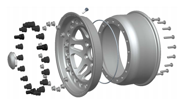

Hutchinson's are great but once you go through rocks and bash up the 15 stud threads (x4 = 60) you'll be lucky to get them off without breaking them!
Some Hutchinson's come with the plastic nut caps but not a great solution.
