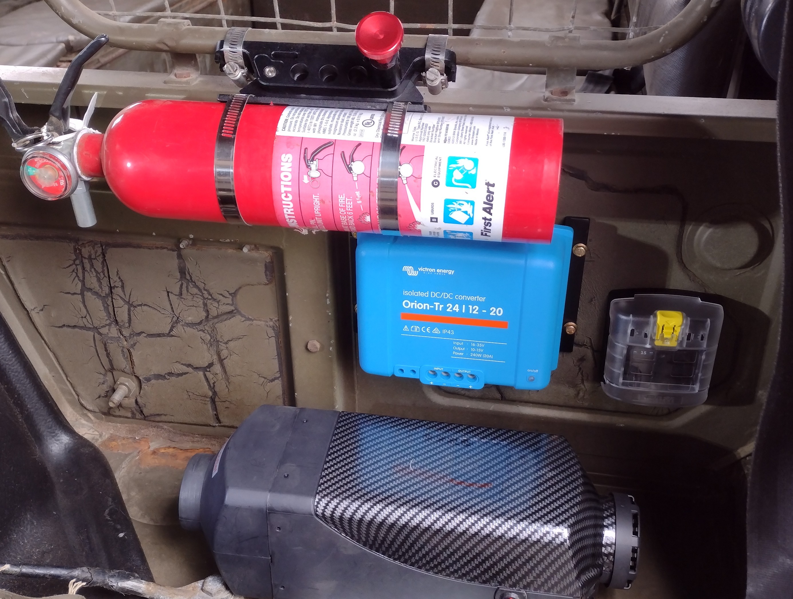

The smaller model you show looks like the one that Willie (SAV) is using for their 230GE Ignition Conversion kit.
https://swissarmyvehicles.com/puch-gwag ... swiss-army

The smaller sealed unit in the original post represents the 10a/20a units. The larger unit pictured is the 70a unit with a thermal switch and fan.
Victron is manufactured in India. I've recently replaced the no-name converter that I was using to supply 12v to the EZ Power Steering and a couple of minor accessories with the Victron Energy Orion IP20 24/12-Volt 70 amp unit. So far so good...

I've used Victron in the past and have been happy with the quality. I have the isolated DC-DC 20 amp converter ready to install in the Pinz once the weather warms a bit and expect it to last just like the other Victron components. Hard to beat the price for what you're getting.

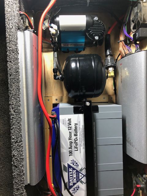

Last year I had it with my 4 Yellow Tops in my 710K and switched them out for a Battleborn
100 A-hr battery, charging via a REDARC dual-input multi-state charger BCDC1225D. Sources
from either the Alternator or roof Solar. A huge reduction in weight, and enough freed up space
to toss in a ARB compressor.
Power Box.jpeg (94.03 KiB) Viewed 11641 times
Just some initial feed-back, hope this helps.
