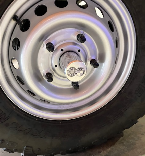

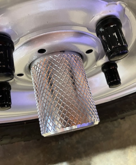

Here are some pics of the steps I made for the Transit wheels. These are aftermarket wheels so not sure if they are the same as factory wheels.
- Photos_sf22bOacdc.png (525.08 KiB) Viewed 4705 times
- Photos_QDEay4u5P9.png (539.71 KiB) Viewed 4705 times
- Photos_3TzalfJhM5.png (597.05 KiB) Viewed 4705 times
Tim

Looks awesome. They should fit the OEM wheels.
I'd take a set -- a bit shorter though.
ron
ron

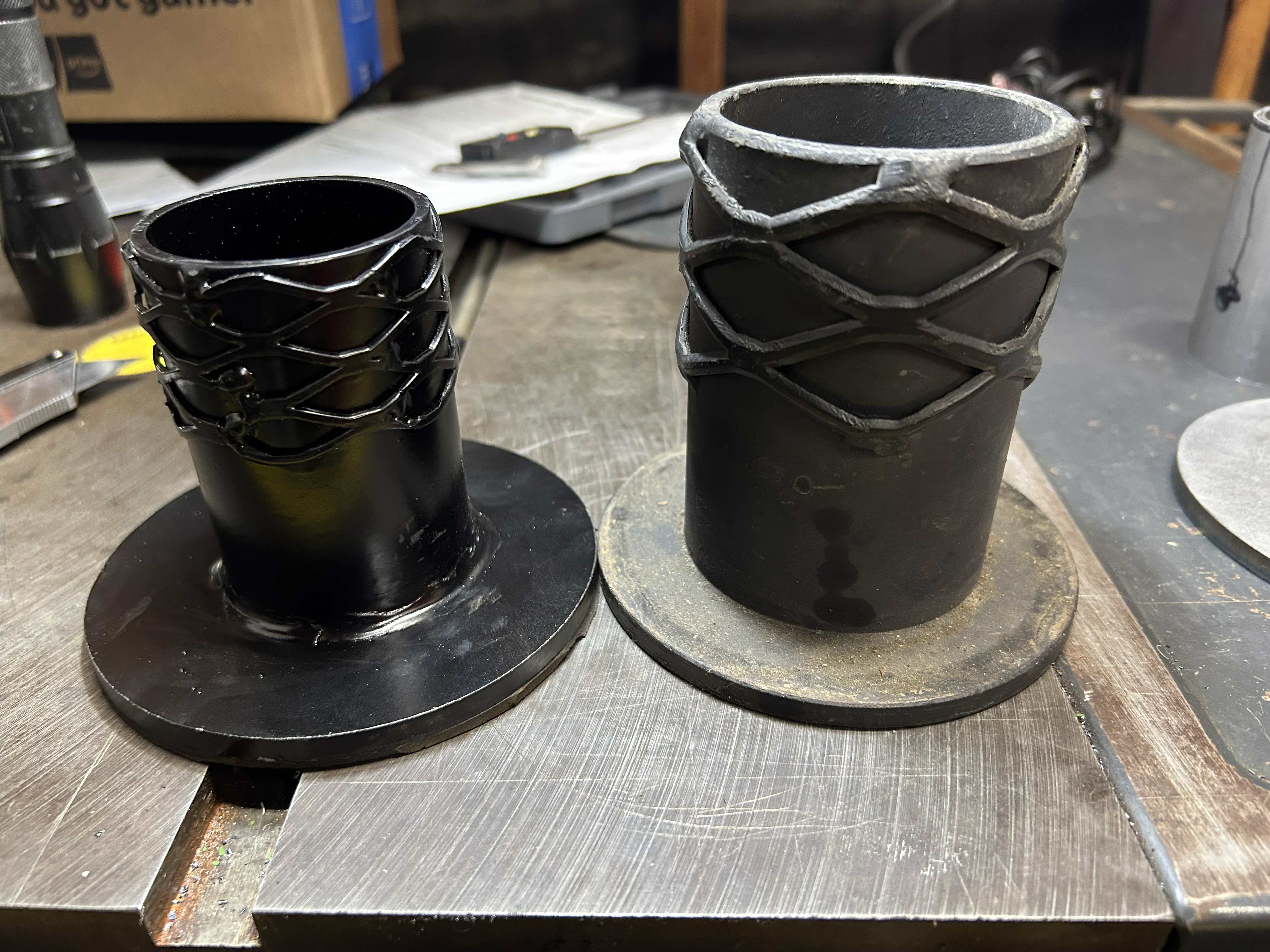

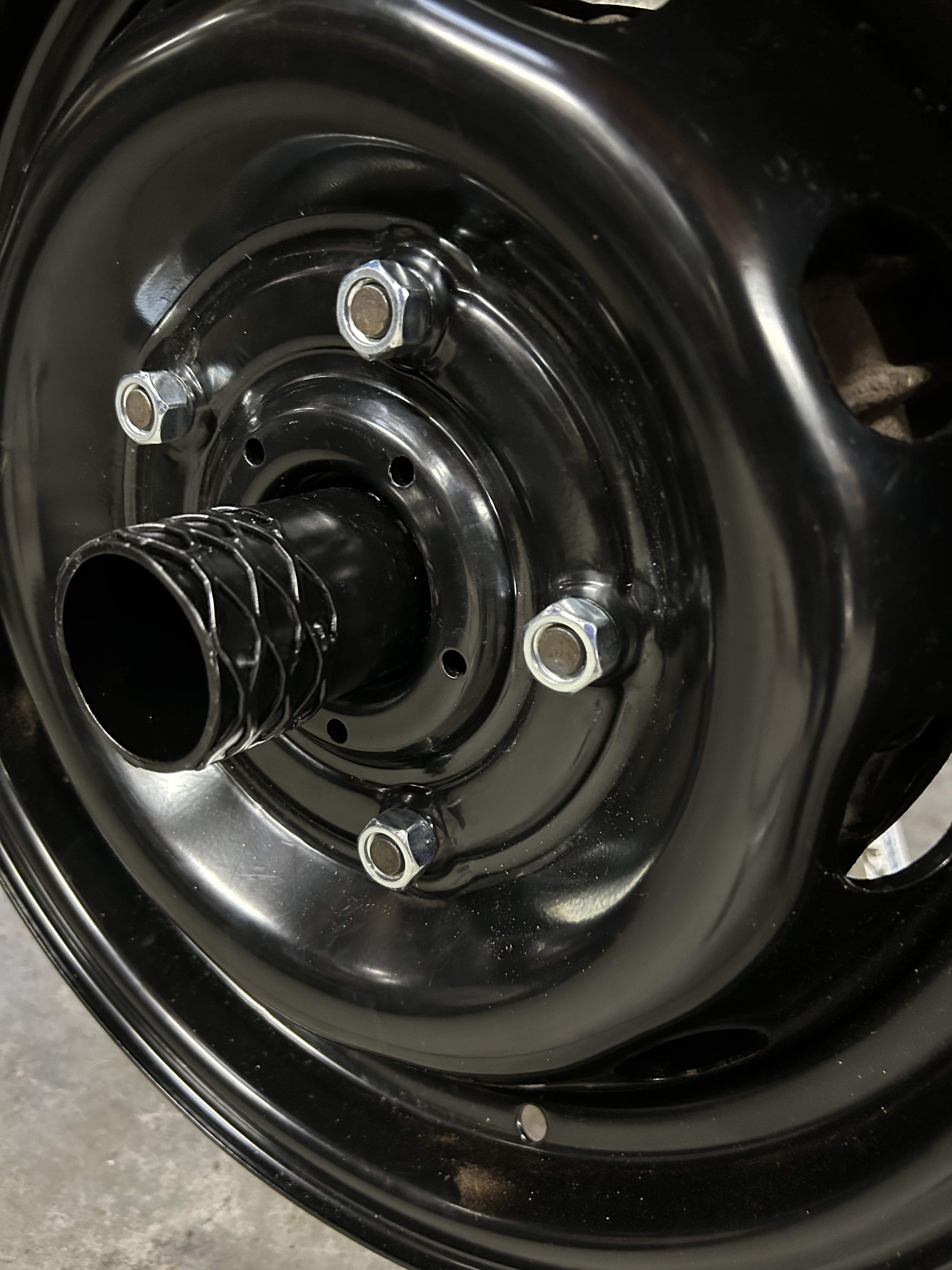

Re: US Ford transit wheels fit the 712k!!!!!
I am moving over to Transist wheels on my 710K. The current wheels are custom 8" re-hooped stock cores.
They are just too wide for the tire width I run.
For a Hub Step, I decide to give it a go and fab one. Not as pretty as the one posted earlier but it's good enough.
I followed the basic design used by Cold War Remarketing (Going out of business).
The base which fits in the wheel cavity is 1/4" stock, jet cut into a circle from SendCutSend. Without a shim
the fit would be sloppy and rattle. To address that I used a 1/8" semi-stiff foam material on the backside to take
up the slop and provide a friction fit W/O interfering with the wheel mounting. Many people do something similar
with the standard hub step using a 1/16" neoprene. Pictures show Wheel and Step, also a side-by-side of the
standard step versus the Transit Step. I cut to a length of 3 1/4" to avoid interference with rocks etc.
